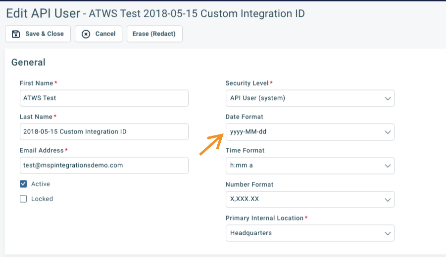

The Autotask API has some oddities and inconsistencies. One thing that’s odd is that all date fields are returned in a standard format, but UDFs that contain dates are always formatted according to the date format of the Autotask API user.
You can easily work around this by editing the API user in Autotask. Change the date format to match the ISO format:

All dates in the Autotask API are always formatted YYYY-MM-DD HH:MM:SS (ISO standard time), EXCEPT dates stored in UDFs. Dates stored in UDFs are formatted to match the format set by the Autotask API user. In my opionion, all dates in the API should always be formatted ISO standard, but Autotask acts differently for dates that are UDFs and that are not.
I recommend you change the Autotask preference to be YYYY-MM-DD, then remove the to_format argument when using {{date ...}}. This will format is in ISO format.
