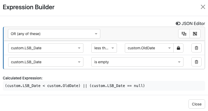

Thanks. I’ve generated a variable custom.errordate using your suggestion, but I can’t get the comparison against the last success date to work.
I’ve tried to do the comparison in “Only perform this action if…” with the expression:
(custom.client.UserDefinedFields.LastSuccess < “custom.errordate”)
I suspect I’m going about the comparison the wrong way.
Are you copying/pasting the Calculated Expression from this builder? Because there aren’t any quotes, etc…
Thanks. That was the problem. With the padlock symbol ‘open’ it generates the quotes. With the padlock closed it works correctly.
